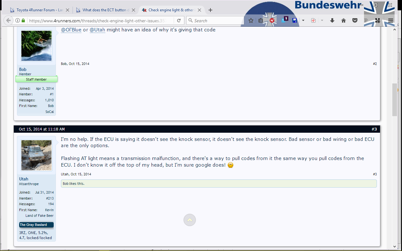

**I saw the post below that I've included a screenshot of below on a forum. Can this REALLY ONLY mean I have transmission failure?
